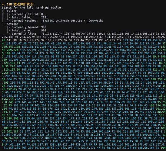

1.2 激进防护
针对端口扫描、用户名枚举等探测行为,比如无效用户尝试、连接异常断开等。比标准防护更加严格,快速响应可疑行为

[sshd-aggressive]
enabled = true
filter = sshd-systemd
port = $PORT_CONFIG
maxretry = $AGGRESSIVE_MAXRETRY
findtime = 300
bantime = $AGGRESSIVE_BANTIME_SECONDS
backend = systemd
journalmatch = _SYSTEMD_UNIT=ssh.service + _COMM=sshd
action = iptables-multiport[name=SSH-AGG, port="%(port)s", protocol=tcp]

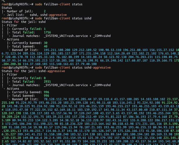

    print_info "=== Fail2ban 状态 ==="
    fail2ban-client status
    echo ""
    print_info "=== SSH标准保护状态 ==="
    fail2ban-client status sshd
    echo ""
    print_info "=== SSH激进保护状态 ==="
    fail2ban-client status sshd-aggressive

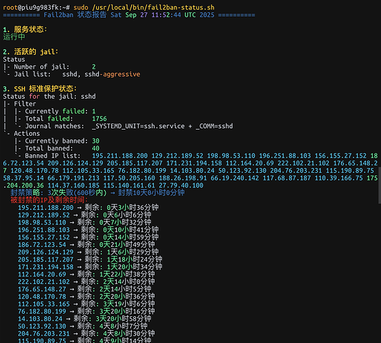

# 创建监控脚本
create_monitoring_script() {
    print_step "创建监控脚本"
    cat > /usr/local/bin/fail2ban-status.sh << 'EOF'

echo -e "${BLUE}========== Fail2ban 状态报告 $(date) ==========${NC}"
echo
echo -e "${YELLOW}1. 服务状态:${NC}"
if systemctl is-active --quiet fail2ban; then
    echo -e "${GREEN}运行中${NC}"
else
    echo -e "${RED}未运行${NC}"
fi
echo
echo -e "${YELLOW}2. 活跃的 jail:${NC}"
echo
# 显示详细的jail状态
show_jail_status "sshd" "3. SSH 标准保护状态"
show_jail_status "sshd-aggressive" "4. SSH 激进保护状态"
echo -e "${YELLOW}5. 今日攻击统计:${NC}"
count=$(journalctl _SYSTEMD_UNIT=ssh.service --since today | grep -E "(Failed password|Invalid user)" | wc -l)
echo "攻击次数:$count"
if [ $count -gt 0 ]; then
    echo "攻击IP排行:"
    journalctl _SYSTEMD_UNIT=ssh.service --since today | grep -E "(Failed password|Invalid user)" | grep -oP 'from \K[0-9.]+' | sort | uniq -c | sort -nr | head -5
fi
echo
echo -e "${GREEN}========== 报告结束 ==========${NC}"

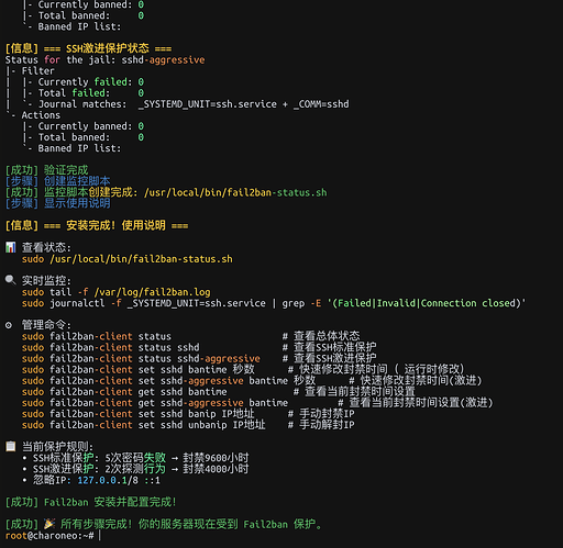

# 显示使用说明
show_usage_info() {
    print_step "显示使用说明"
    echo ""
    print_info "=== 安装完成!使用说明 ==="
    echo ""
    echo "📊 查看状态:"
    echo "   sudo /usr/local/bin/fail2ban-status.sh"
    echo ""
    echo "🔍 实时监控:"
    echo "   sudo tail -f /var/log/fail2ban.log"
    echo "   sudo journalctl -f _SYSTEMD_UNIT=ssh.service | grep -E '(Failed|Invalid|Connection closed)'"
    echo ""
    echo "⚙️  管理命令:"
    echo "   sudo fail2ban-client status                    # 查看总体状态"
    echo "   sudo fail2ban-client status sshd               # 查看SSH标准保护"
    echo "   sudo fail2ban-client status sshd-aggressive    # 查看SSH激进保护"

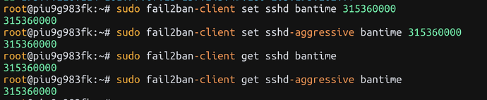

    echo "   sudo fail2ban-client set sshd bantime 秒数      # 快速修改封禁时间(运行时修改)"
    echo "   sudo fail2ban-client set sshd-aggressive bantime 秒数      # 快速修改封禁时间(激进)"
    echo "   sudo fail2ban-client get sshd bantime	    # 查看当前封禁时间设置"
    echo "   sudo fail2ban-client get sshd-aggressive bantime	    # 查看当前封禁时间设置(激进)"
    echo "   sudo fail2ban-client set sshd banip IP地址      # 手动封禁IP"
    echo "   sudo fail2ban-client set sshd unbanip IP地址    # 手动解封IP"
    echo ""
    echo "📋 当前保护规则:"
    echo "   • SSH标准保护: ${STANDARD_MAXRETRY}次密码失败 → 封禁${STANDARD_BANTIME_HOURS}小时"

4.1 查看整体状态
# 状态报告
# 查看基本状态
4.2 查看具体jail状态
# 标准防护状态
# 激进防护状态

5.1 动态调整封禁时间
# 设置标准防护封禁时间为10年(315360000秒)
sudo fail2ban-client set sshd bantime 315360000
# 设置激进防护封禁时间
sudo fail2ban-client set sshd-aggressive bantime 315360000
5.2 查看当前设置
# 查看标准防护封禁时间
# 查看激进防护封禁时间

7.1安装完成
7.2整体报告与每个防护的报告
7.3修改和查看当前的配置
